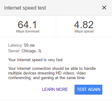

I have switched servers (tried pretty much every US server) and the issue persists. I have also lowered my bitrate from 2500 to 2000 and the issue also persists. Here is an image of a speed test I just ran:
https://i.gyazo.com/ee61a7132d241a727163e440ee473f51.png
I know that my upload speed is pretty low, but do you think 2000/2500 is pushing too it too hard with nearly 5 upload? I am using Ethernet and not wireless, and when my stream drops I do not lose internet connection to other services such as CS:GO or Teamspeak.
