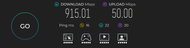

Ookla and other speed tests put my speed around 980 down and 50-60 up with low jitter and latency, nothing lags except OBS during the last few days, it was fine for months before on both PCs

Here's my Ookla from tonight and here's my Twitch Test. It says quality 0.

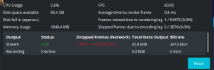

Here's the stats dock from my test tonight after power cycling everything, starting with the modem, then the router, then my PC, unplugging all network cables, and then plugging them back in in sequence after power was restored. Per instructions I waited 5 minutes before plugging back in each device

There's no noticeable errors pointing to your side, so it may be your ISP with issues on the RTMP protocol (so the zero quality) and you need to contact them regarding this.
Do a test stream in Youtube and see if it works. If it do, your ISP may be blocking RTMP traffic to Twitch alone. If it don't work, then your ISP may be blocking or not redirecting correctly the RTMP protocol.
But, before you start a fight with your ISP, double check the modem/router is working fine, change the port where the network cable connects to it, turn it off and wait 5 minutes before turn it on again. Make sure the network cable isn't damaged. Make sure the network adapter driver is up to date. make sure you didn't blocked OBS on the firewall, or the RTMP protocol itself in the computer and router/modem. All this is to avoid doing it when you call the ISP, the most probable culprit.

Speedtests on the internet don't measure the RTMP protocol, so this are useless for your purpose.
so true
