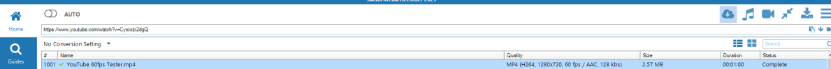

Perhaps there's a conflict on your systems? Heaven's Benchmark is not listed as a conflict but may not have been tested.
That said, I did some testing & recorded the 720p/60FPS test video from the YouTube link you provided above using Window Capture. The recording looks flawless with no skips when playing back at normal speed with VLC. But I went one step further & imported it to Vegas. When going through the recording frame by frame there were some skips. This lead me to believe it was the source/internet.
So I went even further & downloaded the video from YT with Jaksta. Imported the downloaded video to Vegas to make sure it was good with no skips, it checked out OK. Then I used VLC to play it back in OBS while recording. There are now no skips in my OBS recording. I fixed the issue by using the best source possible.

rockbottom
Here's a link to the downloaded YT test video & my OBS recording with no skips. The only skip you'll see is when the video loops. The link is good for a week.
