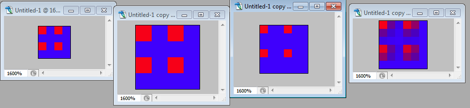

The main reason I talked about sticking to multiples of 2 with resizing was because of things like https://pbs.twimg.com/media/CQNMTdJWEAAegmE.png:large (left is 4x4 source, then 8x8 nearest neighbor upscale, 6x6 nearest neighbor, 6x6 bicubic). Obv 8x8 looks best. But immediately after, I started wondering about some edge cases.

2. Are there any intermediate numbers when upscaling or downscaling? Assuming x2, x4, x8, w/e are going to be best, but is a 1.5x upscale better than 1.49x?

2) Yep. A 1.5x downscale will have a regular pattern to its scaling, and will be easier on the eyes. A 1.49 downscale will tend to be irregular and look worse.
