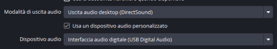

Greetings,
I connected my switch to obs via a capture card but the audio is not heard.
I've been doing this for a year now, never had a problem, now I changed some audio settings, they didn't work and I brought everything back to how I usually keep it but the audio doesn't work!!!!!!
Could anyone tell me why?
And could someone also explain to me how to reduce the audio delay as much as possible without setting "Capture audio only" But keeping a DirectSound audio output?
Then look at the first picture.
Usually the sound waves of the switch are shown there (or at least I think they're called that, I don't know the technical name) but now they can't be seen.
What could be the problem?
In the last picture there are my switch audio settings
Sorry for the pictures in italian, but if someone can help me i'm thankful.
