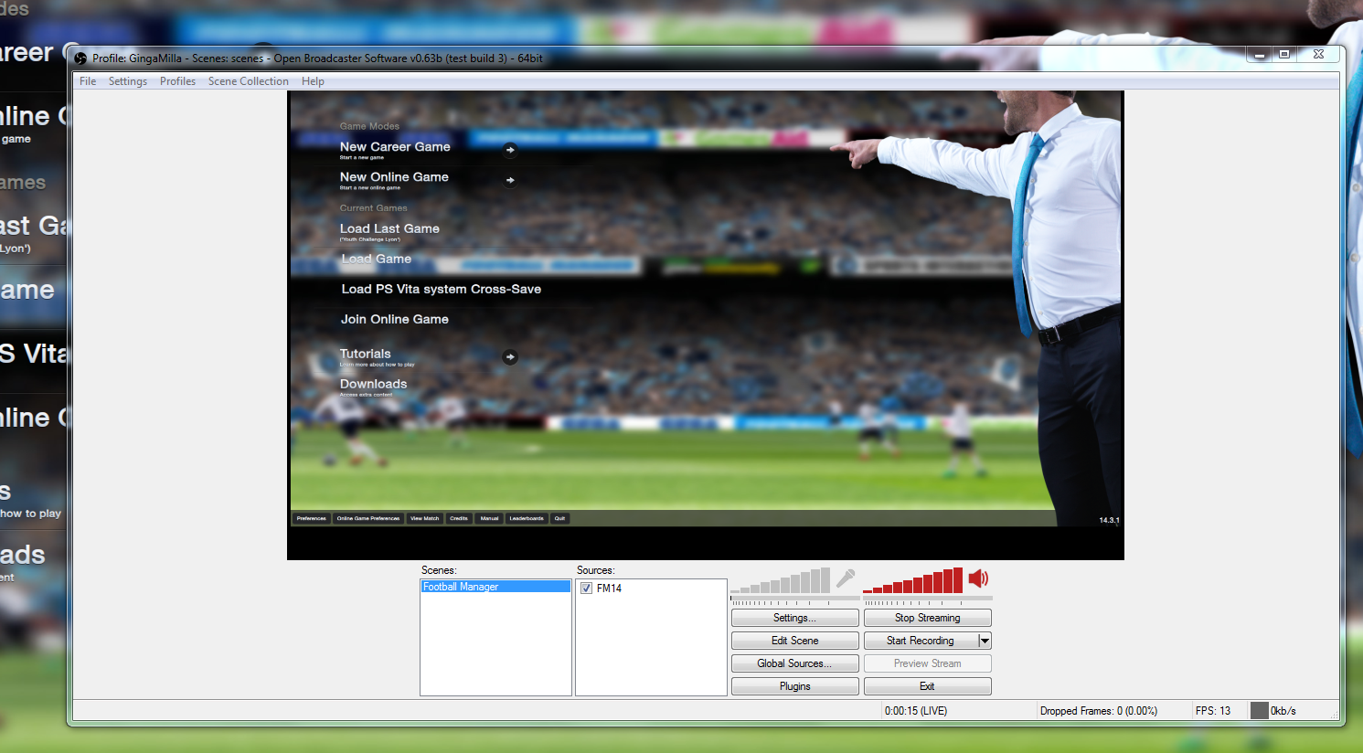

I am having a problem with OBS. It seems it won't go live at all. I have done all my settings, I press start streaming and then it says it'll go live but no bandwidth is being used nor is it live on my twitch channel and after a minute or so it disconnects and tries to live stream again.My upload it at 3mb/s if that helps?
Here is a screenshot of my problem. http://i.gyazo.com/2715791afd1cfcae2d281202d166415c.png

Well, according to the log: "Could not access the specified channel or stream key. This could be because the key/channel is invalid, or because the server still thinks you are logged in."
Are you a new user?
Lain
Forum Admin
Lain
Forum Moderator
Developer
Okay, if you're 100% positive that the stream key is correct, then don't keep trying again and again, give it like 15-20 minutes before you try again.
