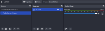

I'm having a problem with OBS not receiving audio from my MG10XU via USB or any other type of connection, even though it recognizes the mixer as a source. I've tried every setting available. but it just won't register the audio signal. I had this problem on my old computer, but managed to eventually resolve it. Also, it was working for a while after I upgraded systems, same settings as before, but stopped working a couple of days ago for no apparent reason. I'm using the latest Yamaha Steinberg drivers(2.1.6) and the latest OBS release. I'm hoping there's something in the log file that might explain the issue, and would greatly appreciate any help.

Anyway, I followed your instructions, and restarted OBS, as changes do not always register in real time with the program. I should also provide information about the hardware chain, MacBook Pro > DDJ-1000 Controller > Yamaha MG10XU > Dell XPS 17 9730 via USB 2.0 connection. I'm getting audio out of the mixer, but OBS, even though it recognizes the device, is not receiving the signal. I have no explanation for why it suddenly stopped working, as it did work for the first week or so after I first opened OBS on the new Dell without my changing any of the settings from the previous laptop which was a Dell XPS 15.
After I restarted OBS, I activated a track on the controller and plugged a pair of headphones into the MG10XU to verify it was receiving the audio signal. It was. The VU Meters were jumping and I could hear it plainly. No activity in OBS. It still recognized the mixer as the input source, but the VU meters were dead. I made a recording and there was no audio on the recording.
I've uninstalled and re-installed every relevant driver and OBS itself multiple times, but that doesn't fix the problem. I'm including a bundle of screenshots with my OBS and Windows sound setting with this post, hoping you might find them illuminating. I truly appreciate your help.

While you see in OBS log:
[WASAPISource::TryInitialize]:[Line (MG-XU)] Failed to initialize audio client: 80070005
nothing will work, no matter what number of channels it has.

So it *is* multitrack, and you're using the higher channel numbers. I would not expect that to work. I don't know for sure, but I suspect that OBS takes anything above 7.1 as if it were 7.1 on the lower 8 channels, and ignores the higher channels.
If you could use channels 1-2 and keep the rest silent *from the board*, then it would be like I did for a last-minute outdoor gig with a live stream. It was technically downmixing 7.1 to stereo, but I set it *in the mixer*, not OBS, to be all silent except for what OBS thought were the front corners, and so that mapped nicely into the stereo that I wanted. It would have been better if I had set the mixer to 2 channels instead of its native 18, but it worked.
It you can keep channels 1-6 silent and use 7-8 like you say you can, that might work too, but you'll get a lower gain from the mixdown because those are the side channels, not the front. But you do need to keep everything else silent, because you can't avoid the mixdown.
Would it be advantageous to deselect all but one of the tracks in the Advanced Audio Properties, since OBS apparently does not like multi-channel inputs?
No. The track selection in OBS is at the *output* end, not the input. You might think of it as submix groups on a larger console, except that each of them contains the same channel count that OBS is set for in Settings -> Audio. The downmix from what it thinks is surround to what it's set for, is the very first thing at the input end, and happens before you have a chance to touch it at all.
