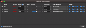

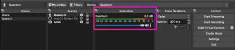

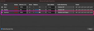

I have the same issue. Running Mac Ventura v13.5 (22G74), OBS 29.1.3
Check in Audio Midi Setup (the application, not the system settings) that the microphone you want to use is selected as the active input device. Also, make sure the global audio settings in OBS are OK.
