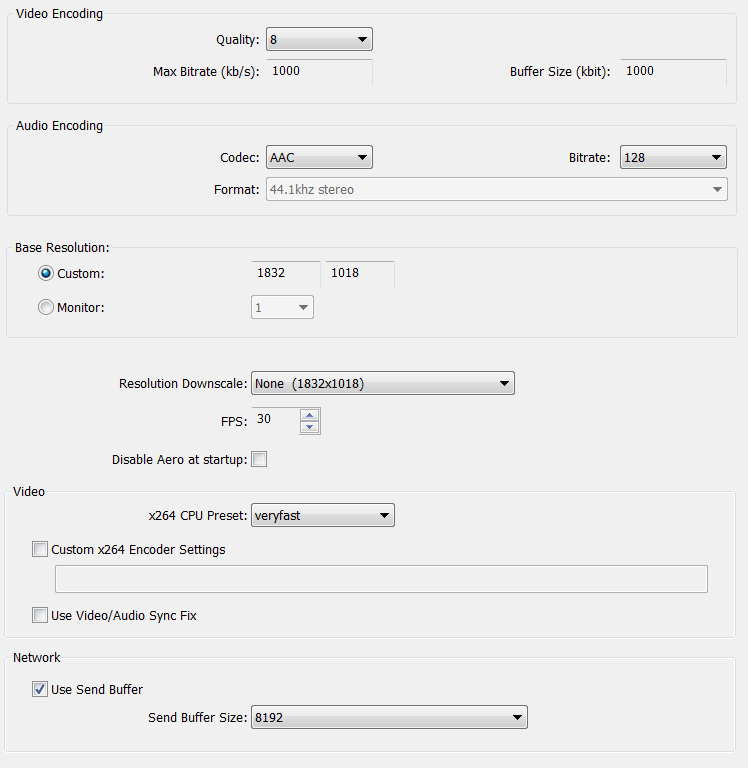

I think I've sorted out most of my problems now, I was a bit hasty with posting here... hehe. Not sure where the random disconnects come from, but changing twitch server seems to fix that. As for the stream hiccups, it seems all I had to do was to lower TF2's settings, changing anisotropic filtering to trilinear seems to have helped in particular... I think.
I'm trying out 1920x1080->1280x720 at 30fps and I have a sandy bridge 2500k running stock settings. I increased the quality a bit after lowering the settings in tf2 -
quality 5, max bitrate:2000, buffer size:5000 and the veryfast preset.
that sounds about right... i thought you got those results from 1k bitrate and was like wow. 2k bitrate is the minimum for 720p for high quality
Fred_
Hmm, I think that the "after" vid i posted was running different settings, but I can't say for sure what settings. If you're interested in what the settings I posted look like, you can see it here. I should probably lower the ingame settings a tad bit more to stop the last few hiccups.
