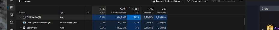

tried to stream right now.
again after 20 min obs got over 80% GPU
so the stream startet to "freeze"
i dont know what i can do, before i reinstalled obs, i "just" had problems with random crashes, but the gpu never overloaded like now?
there is no crash file i stopped the stream because it was freezed.
Dunno.. maybe again uninstall and install ?
Phandoumas
Ok
i turned the Game Mode on Win 11 to off (dont know why it was on)
set Diablo 4 to LOW
then i disabled Nvidia Broadcast on my cam for remoce background (but it had only 1% gpu before)
then on the graphic settings there is an option "optimize on window mode games" i activated it
i streamend for 2 hour without problems
