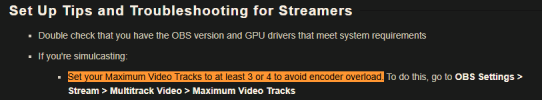

Ok, you mentioning Enhanced Broadcasting I think helps a bit. I did set something to 4 when setting up Enhanced Broadcasting, but the setting was not named lookaheadDepth, or anything remotely similar. The setting I changed was called "Maximum Video Tracks" under File>Settings>Stream>Multitrack Video.
The official Twitch page explaining how to set up Enhanced Broadcasting suggests setting this to 3 or 4 if one is multistreaming to avoid overload.
This is the only thing I changed. If this is not what you're talking about, I'm completely lost.
Thanks anyway.

It almost looks like to me that Aitum Multistream youtube output isn't trying to stop until after OBS is closed and happened at the same second of the crash from the time in the crash log (6:31:57). By chance are you not stopping the youtube stream separately or not allowing enough time for it to turn off completely before closing OBS?

Your suggestion seems to have worked. OBS isn't crashing on close anymore. Thank you!
Nice.
I don't use Atium but do use the RTMP Multi-out. It has a setting that you can sync the normal output with the multi-out. Stop the main stream, they all stop. Atium more than likely has a similar setting.
