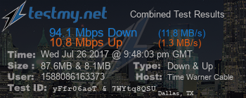

TestMy Speed Results: http://testmy.net/yFfr06aoT.7WYtq8QSU.png

I have Spectrum internet in the Central Texas area, 100Mbps/10Mbps high speed broadband. I use a DOCSYS 3.0 modem and a NETGEAR WNR2000v3 latest stable firmware.
The attached screenshot indicates the intervals in which frames begin to drop out of the GREEN into the amber/red zone.
The second attached screenshot (if it posts) shows that I have bandwidth of 10000 kbps, RTT's of 20-30 ms, and qualities of 100 for the three US Central region Twitch ingest servers in Dallas, Houston, and Denver just moments after I stopped my Twitch.TV bandwidth test on OBS. Then I try the Twitch.tv bandwidth test again and this same every-40-seconds issue resumes itself.
