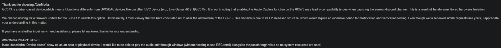

As for why the card doesn't work like we want it to, I got the below response from Avermedia support:
Thank you for choosing AVerMedia.
GC573 is a driver-based device, which means it functions differently from UVC/UAC devices like our other UVC device (e.g., Live Gamer 4K 2.1(GC575) . It is worth noting that enabling the Audio Capture function on the GC573 may lead to compatibility issues when capturing the surround sound channel. This is a result of the aforementioned hardware limitation.
We did considering for a firmware update for the GC573 to enable this option. Unfortunately, I must convey that we have concluded not to alter the architecture of the GC573. This decision is due to its FPGA-based structure, which would require an extensive period for modification and verification testing. Even though we've received similar requests like yours, I appreciate your understanding in this matter.
If you have any further inquiries or need assistance, please let me know, thanks for your understanding.
AVerMedia Product: GC573
Issue description: Device doesn't show up as an input or playback device. I would like to be able to play the audio only through windows (without needing to use RECentral) alongside the passthrough video so no system resources are used.
Though it would be nice, I see their point as it's a pretty niche use case (I had the capture card for ~2 years and never knew I wanted it until recently.
