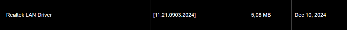

Checked on the device manager and all my drivers were up to date according to that. Im currently checking into my MOBO`s support website and this is what I have, but I have no idea of what I should be looking for exactly? also reinstalled OBS from scratch just in case
