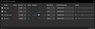

These are my settings, I've set it to be my specific mic

You're recording 3 tracks, with Track 1 having the Mic and Desktop audio, and the other two Tracks have just one thing each. Alert Box and Chat don't go anywhere. Is that what you meant to do?
Since you're recording multiple tracks, there's the question of what your player actually does with that. Most will play Track 1 by default, and some allow you to choose which track to listen to. Movies use that for alternate languages, and for descriptive audio for the visually impaired.
I suppose it's possible that your player decided to not play audio at all, if the file contains multiple tracks. Or maybe you just have it set for a track that doesn't exist?
At any rate, the settings tell me that the file should indeed have it.
