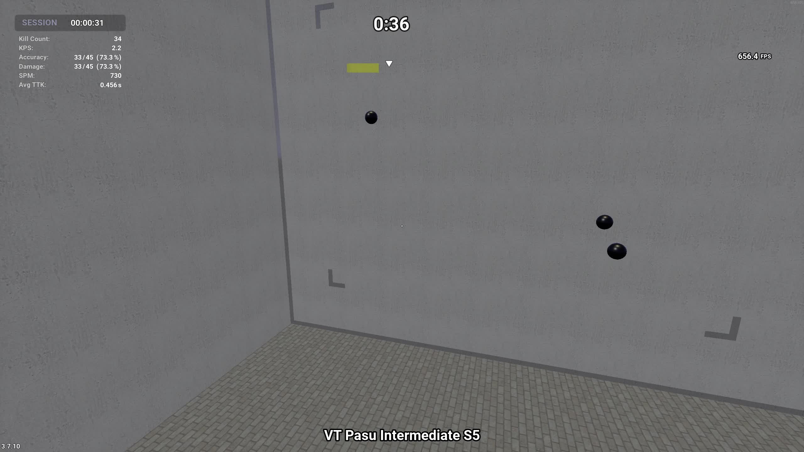

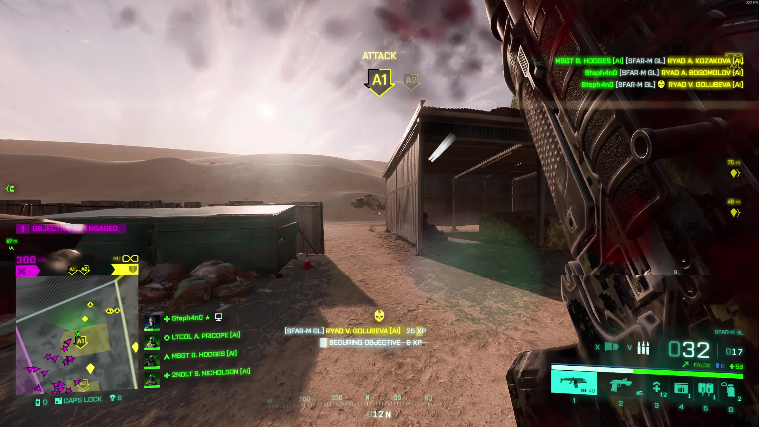

Was able to try your suggestions but it did not help. One thing I noticed was that for battlefield 2042 the recording was pretty smooth at 1440p, but it was only in Kovaaks where the recording lag occurs.
Currently have no fps cap, but even with a fps cap at monitor refresh rate my recording still lags. My GPU is nowhere close to max utilization even uncapped FPS.

So I tried many different video playback apps already, its just on one game it seems like.
I never had the same problem with that game before but I may try a clean install of my GPU.

This is the difference in recording smoothness between games. I had to degrade the quality a bit using a clip sharing site I dont pay for but it does the job for this context I think
BF2042:
log-file (new recording):
Kovaaks:
