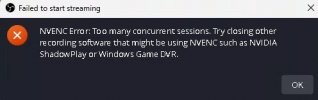

And then after I closed the three streams and tried to restart them I got this error. and when I looked in the system tray there was 3 instances running and yet I couldn't stop them and everything was closed so when I was starting new streams it was multiplying them all of a sudden there was four streams and five streams and six streams in the system tray. I actually had to reboot the computer to get things cleared up not a good thing. This computer/server is dedicated to BS I shouldn't have to mess with it ever. there is no crash report.
