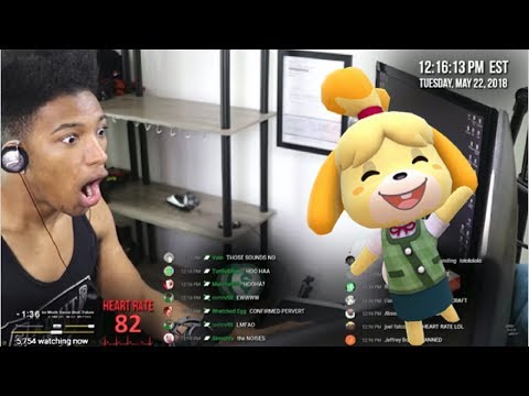

What if I have my webcam in there?
It depends on the size of the webcam. If it's going to be taking up, say, a sixteenth of the screen and put into a corner, 240p should still be fine. If it's going to be larger or on the side, you should go for 360p minimum, 720p maximum, 480p ideally. 30fps still is fine.
This should only need 240p. (assuming you have no overlay)
This will be better with 480p.
