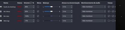

And I have a USB microphone, and I plugged in the instruments that are plugged into a soundboard in the input line of the PC. But when I put both in the mixer of Obs works only one, in a live broadcast, the Obs accepts a single track, but I see both but only comes out sound of one
I can not send a print now, but I have in this part the two sound inputs, the USB and the line in, but in a live broadcast, the Obs allows me only 1 sound track, and when I put the two inputs in a sound track, only one of them comes out the audio.
"Track" has a specific meaning here. Let's see your screenshot, and see if we're using the same definitions.

I changed the microphone input, but two microphones don't work at the same time, now I have a usb microphone and one in the p2 input
everything is in portuguese
View attachment 96632sorry
Retyping into Google Translate with the wrong character set, seemed to get me enough anyway. Or at least it made *some* kind of sense. :-)
One potential problem is that you're using the Default setting for your Desktop Audio. That is likely to change what it connects to when you plug in or unplug things. Always choose a specific device, so that it doesn't end up listening to the wrong one. If it works for one session, but not the next, and you don't think you changed anything, that could be why.
Another possibility is that your second mic looks to be a built-in sound card. Maybe that's where you have the soundboard plugged in, but most of us that are past the point of just playing around, don't use that because the quality isn't so good.
USB everything: get all of the analog circuitry out of the noisy digital box that the computer itself is. And *good* USB stuff too: not a repackaged version of the same chip that's designed to go inside the noisy box and therefore has no motivation to be all that good itself.
If you're already doing that - USB everything - then choosing the internal sound card is not what you want, except as a last-resort-backup.
Your meters are different, so you have 3 different sources of *some* kind. But one of them is muted. Is that your missing audio?

The one that is mute is the microphone p2 that is not coming out the sound along with the sound table
