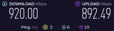

Attached speedtest screenshot for network.
I've tried x264, AV1(youtube only for stream), AMD HW, nothing seems to work. Tried all the bitrates, tried running variable (that was even worse), tried running default settings, almost anything. Tried rescaling and without. Also, i'm trying to stream 1080p@60frames but whenever i check my stream online i can only go up to 720p. I've also watched the vods, the streams till was pixelated/blurry. I also use a camlink if that makes any sense.
