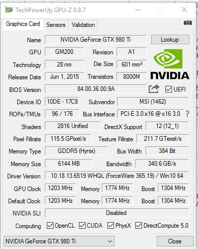

Question / Help having issues streaming overwatch
LainGG
issues
Late frames detected
Skipped frames detected
Specs:
i7 5930k @ 3.5ghz
980ti 6gb
16gb DDR4 ram
  • 2016-05-24-0642-06.log

LainGG
Then it's probably a driver issue. If you notice in the log:
This is more than a little bad.
Ideally, this should be (and with my GTX 970 I do get) under 1ms.
what can i do to resolve it (i have the latest nvidia driver)
