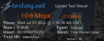

Upload bandwidth can more than handle the settings:
Although I don't see that making a difference in this particular case.
i7-4790K and a GTX960 shouldn't have any issues keeping up either (and according to resource monitors, don't)
