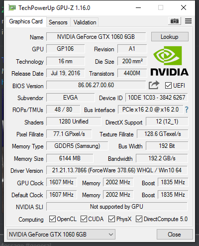

I know that it's already on the PCI-E slow because I built it, but how do I cap games? My refresh rate is 1ms and is 60hzI'd make sure the video card is in pci-e x16 (check using gpu-z)
After that, I'd consider capping the framerates in the games to the refresh rate of your display
http://gpuz.techpowerup.com/17/02/26/6qd.pngProvide a screenshot of gpu-z then please.
Why do I need to cap my game?FPS capping of games usually happens in the games' settings.
Which is what you need to do at this point.
