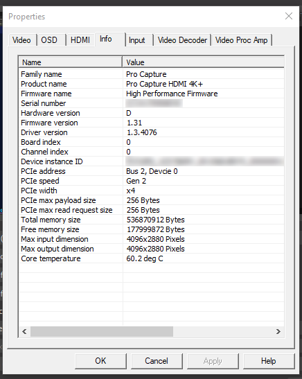

Yeah my card is running in a 4x slot at 4x, this was something I made sure of a few years back:
