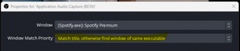

When you use application audio capture on Discord you must have the voice channel in the window for it to capture audio. Is there no other way for this to simply pull audio from the entire Discord program? Am I overlooking/missing something? Any help would be appreciated.
When you capture audio from an application through its process you need to make sure it is windowed and not minimized to the systray.
The problem follow with discord and spotify.
And don't forget to specify this option too.
