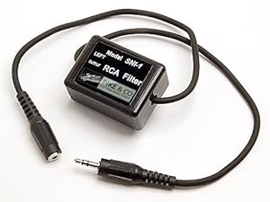

If the noise is a ground noise, u can buy a filter wich is filtering this noise. Search for ground filter and pick one. Eliminates ground loop noise between the audio source and radio. Can be used for car, MP3 Player or home stereo.
