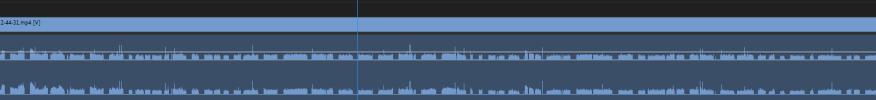

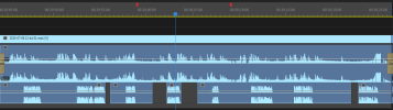

I am attaching a photo of the damaged track, the screenshot was taken in Premiere Pro. The problem area is highlighted with a frame (lasts about 10 minutes), and in the second photo I enlarged it. On the bottom track is a recording from the microphone, and you can see that the problem affected only the game track.

Thanks for the answer. As for the logs, it looks like OBS has already replaced them with new ones while I was opening OBS to take screenshots. The log doesn't have the date when I recorded that video, only today's. I'll attach it if it helps.
And as for the other program, I played this fragment in VLC media player, there you can clearly hear these artifacts, that the sound is interrupted and stutters, as if someone quickly presses pause. And I also took a screenshot from another audio program, for sound restoration (it's quite popular), and there you can also see these gaps in the sound.
