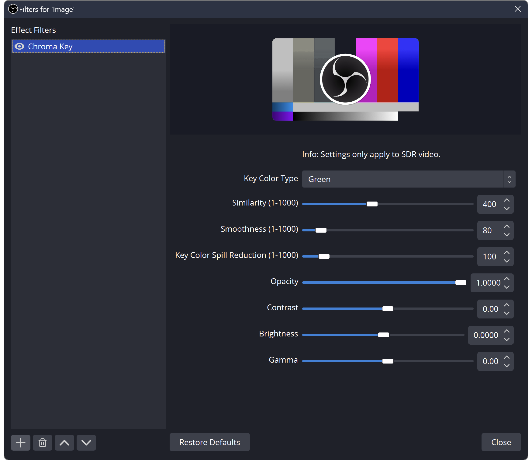

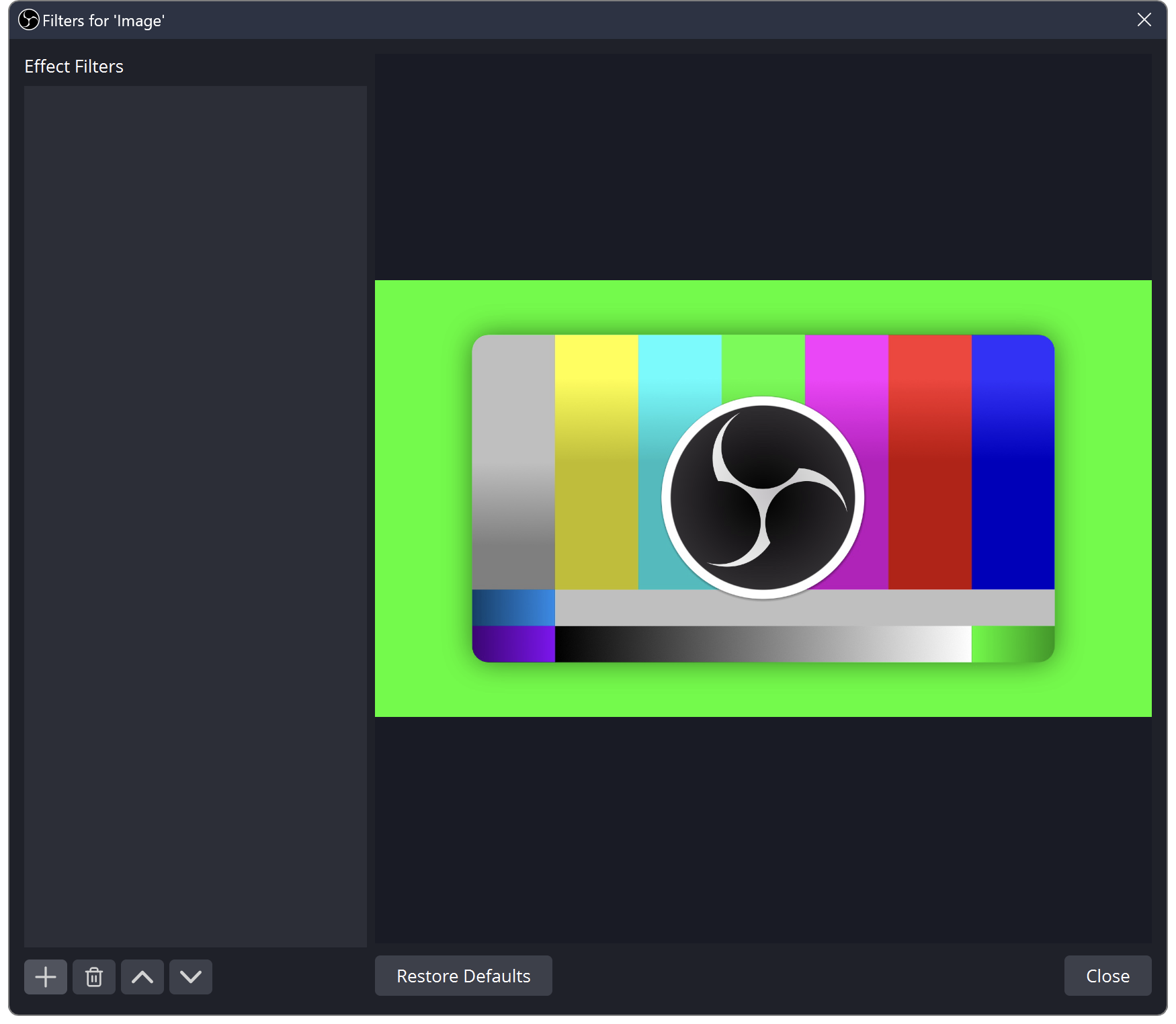

Removes any instances of a given color from the Source. This can be controlled so as not to remove too much. Use this filter for green screens.
Properties
| Property |
Description |
Default |
| Key Color Type |
Specifies the color to key out. You can also set a custom color |
Green |
| Similarity |
Sets the similarity threshold between the defined color and those found in the Source. Lower values will remove fewer pixels; higher values will remove more aggressively, possibly removing what you intend to keep |
400 |
| Smoothness |
Specifies the smoothness of the color removal. Lower values leave hard edges around removed pixels; higher values soften the edge of removed areas |
80 |
| Key Color Spill Reduction |
Specifies how aggressively to remove traces of the key color from the Source around the edge of other colors (for example, green pixels around a subject's hair) |
100 |
| Opacity |
Sets the opacity of the Source. 0.0 is transparent; 1.0 is opaque |
1.0 |
| Contrast |
Sets the contrast of the Source |
0.0 |
| Brightness |
0.0 |
| Gamma |
Sets the gamma of the Source |
0.0 |
