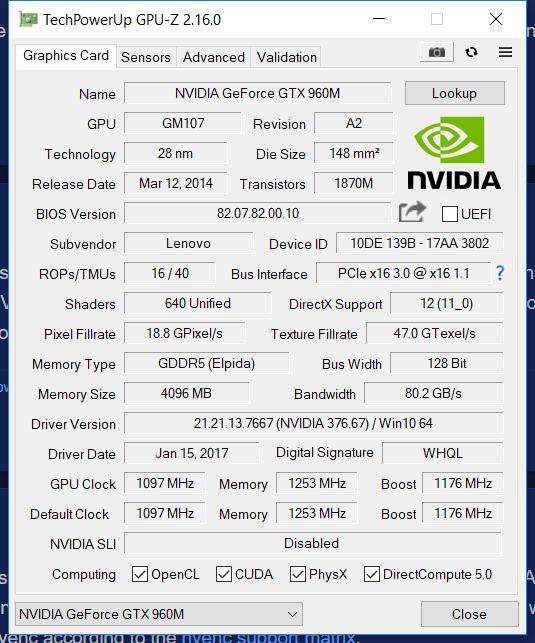

Could you run GPU-Z and post a screenshot of the first page? In that page we can see what chip is actually built in that GPU. It should be the GM107, and that has Nvenc according to the nvenc support matrix.
Your driver is not current. It's not old, but it's not current as well. May be installing the current driver from the Nvidia website might help. As of this writing, it's version 417.71.
Thank You! Manually updating the drivers from the website seems to have fixed the issue. I had it updated automatically when the issue first happened but for some reason it must not have gotten the most recent version.
