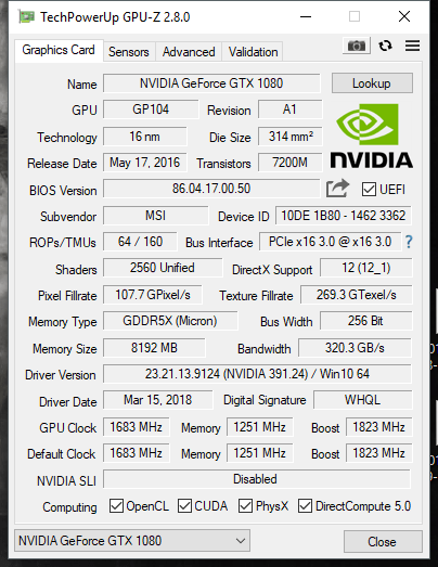

Makin
Post a screenshot of the first tab of gpu-z please.
Here you go:
Harold
It's probably to do with the secondary display you have connected being a different refresh rate from the primary then.
