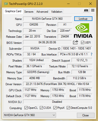

Ok til yesterday i got i5 4460/16gb od ddr3/GTX960 4 gb/120 gb ssd
my stream worked amazing on 720p and 60 fps.
Today i got myself I5 7600K with 16 gb od ddr 4 and i got same graphic and ssd
And i got problem:
Droped frames are 0% cpu is 20% with all my specs and the point where it says 60 FPS(that drops to 20-35fps and laggs the hell out of my stream)
tryed everything with bitrate 30 fps.even downscaling rez to 480p,encoding to worst,new drivers and so on.still same.even if i put X264 or nvidia as rendering encoder or so.same stuff happening on classic and studio OBS.
here is all ive got so far.can anyone check and see.

and pictures
p.s Got clean win 10 instaled,all new drivers.
