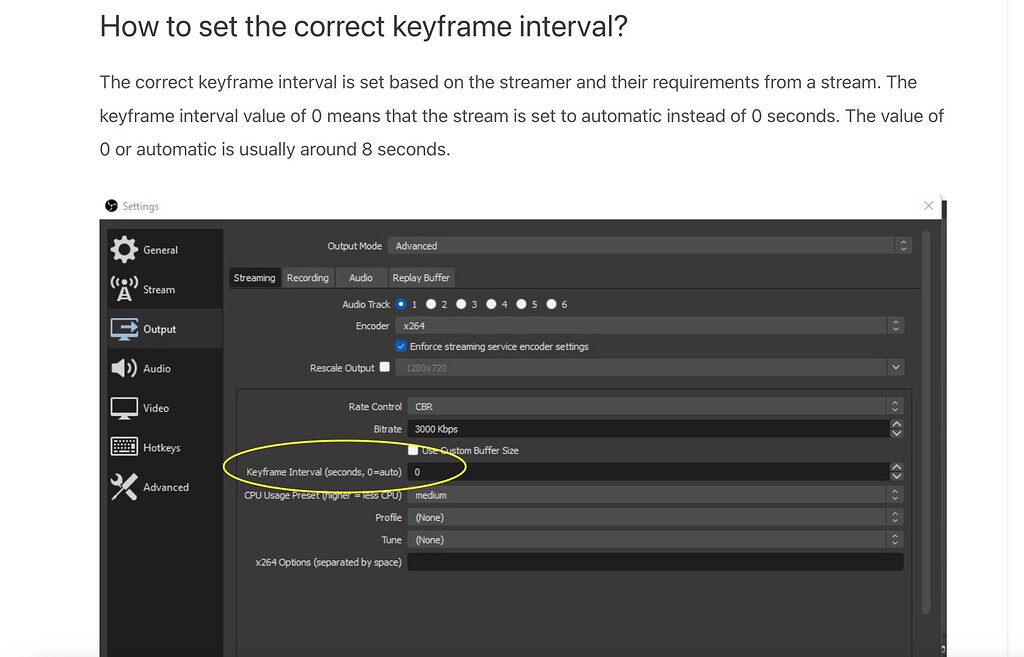

Bleifresser
The only thing besides a lot of error messages in the log, where I can't help you with, is the keyframeinterval. It pretty high. Its recommended to set it to a lower number like 2.
Explanation:
