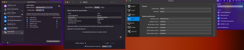

Hello,
I'm rather new to OBS and related software. It's my first try of recording / streaming my screen as well.
I'm having hard time trying to record my system audio. I tried almost everything I could possibly find in different tutorials (from this forum and YouTube), but no luck so far.
I use Macbook Air M1 with MacOS 12.3 Monterey.
The current status is as follows:
* BlackHole 2ch installed and properly visible in the system
* Multi-Output device created in the MIDI Setup (
* Multi-Output device from above enabled as the default system's output
* OBS configured to use BlackHole 2ch
When I play some music in the background (e.g. YouTube or Spotify), the bars in OBS don't show anything. When I then record a video, there's no sound on it whatsoever. But if I use system's screenshot tool with BlackHole 2ch as the sound option, it records the sound without any problem.
Here's my log file: https://obsproject.com/logs/85XuylV_fN8OG3dp
I'm attaching a few screenshots to show my configuration.
Is there anything obvious I'm missing? Is there anything I can check to make it work? I'll appreciate any help!

I finally got mine working like a charm. Here is my setup. Hope that helps. 12.2.1 Monterey.

Its a usb microphone, Its not output, its input... Well I do have my headset connected to it so I guess its both output and input.
The settings I posted is all I did to my system. And it finally works flawless for me.

Hey, I spent couple of hours to make OSB recording audio via BlackHole, Screenflick Loopback or iShowU and the only reason why it havent been working is that I didnt allow acces to microphone. (Privacy settings -> microphone) After I did so it started to be capable detect the audio.
