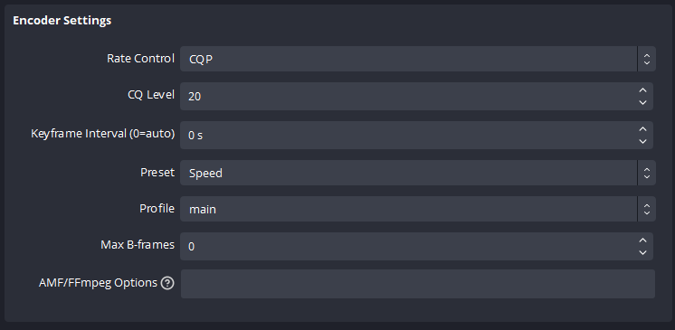

I can't find anywhere to set the view mode to advanced. can you post a screenshot of where that is in the options?
thanks
Here you go:
http://i1292.photobucket.com/albums/b575/BornDownUnder/OBS View Mode Location_zpshnrkuomz.png
Make sure to select Advanced, Master mode gives you a lot of extra options that you don't really need unless you want to tinker with them to find out what they do or are trying to squeeze out the maximum quality/performance, most of which are undocumented at present.
Magnus_
Here you go:
View Mode isn't an option in my video encoder settings.
