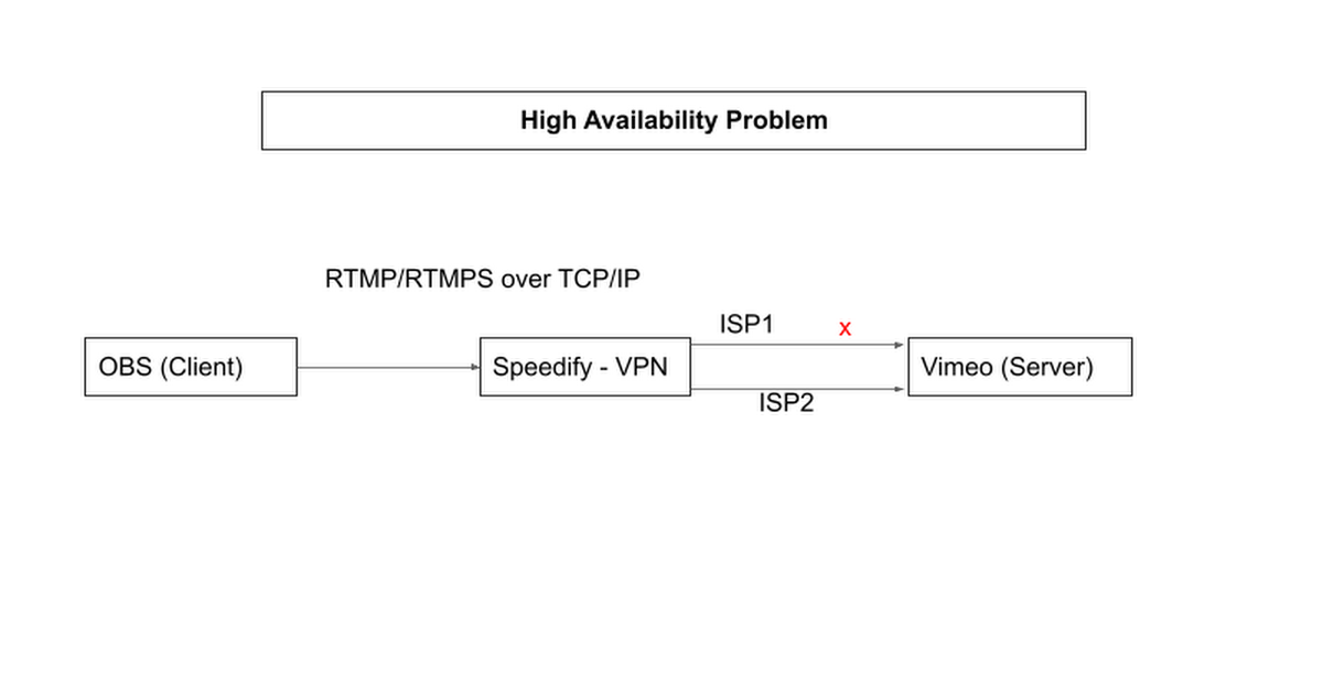

Bandwidth is not a problem. Our issue is something more like this:
Remember, if we replace OBS with vMix, this issue does not happen
Lawrence_SoCal
Whoever wrote the Google doc doesn't understand networking. In that picture/image, it is the network software / devices responsibility to handle the link fail-over, not OBS (or any other app).
In you case, the fact that vMix works is irrelevant/coincidental. vMix's settings/assumptions are different - and that just so happens to work in your environment - ok fine. OBS is very flexible (in exchange for you having to know what you are doing, and not be hand-held to get there... nature of FOSS , especially where/when there isn't a commercial company offering paid support services), so go ahead and configure OBS to match vMix. Maybe others can help you... but I've never used nor do i have vMix, nor specific network monitoring details for all the relevant portions of your network to give you any guidance on exactly which settings to adjust to mimic what settings you have set (or are default) in vMix
if you do your research on occasionally bandwidth constrained livestreaming, the advice for addressing that situation in OBS will apply to your situation
