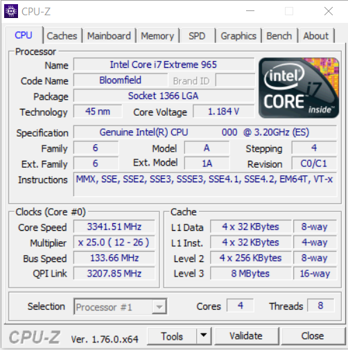

Here's my computer specs: https://i.gyazo.com/d22c4c55132ec00b42d56b851bd243fc.pnghttps://i.gyazo.com/c87969fd2531c6cec9754fd9701a62be.pnghttps://i.gyazo.com/06cb9ad8ccc3a6b6842ba143564f303d.png
