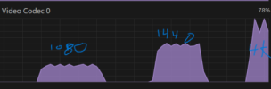

zelda0466
see
ciinTri
Video Encode usage doesn't necessarily completely define how good the Picture Quality will be, the resolution helps of course. We're talking about Video Encoders/Codecs (x264, H.264, HEVC/H.265, AV1), each Video Encoder/Codec produce different results for the Picture Quality.
zelda0466
so the only reason why im saying it not the encoder its software is cause im using an amd cpu THE SAME ENCODER STUFF IS IN THE 7900XT SOOOOOOO if the 264. is a good (software) to use then the gpu (software) IS THE ISSUE
