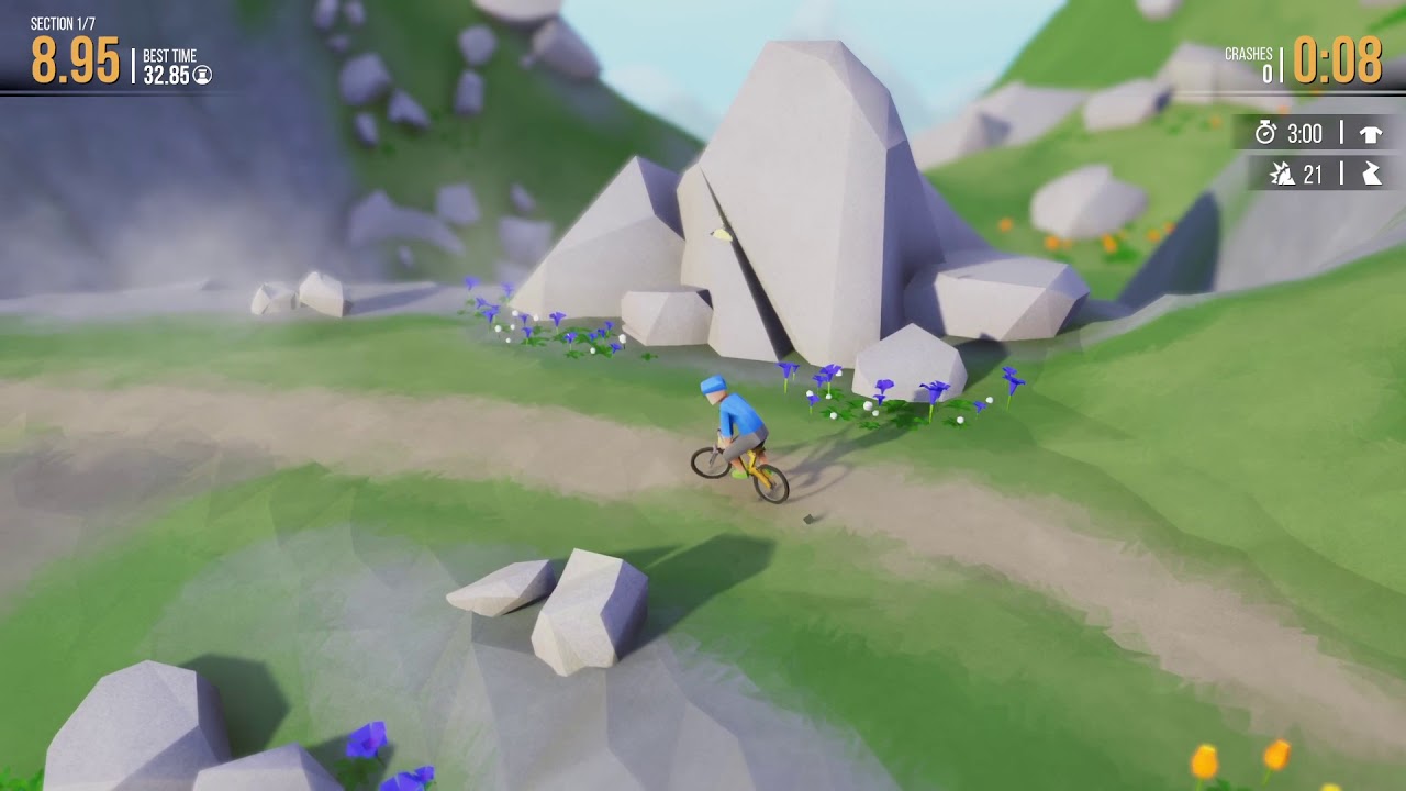

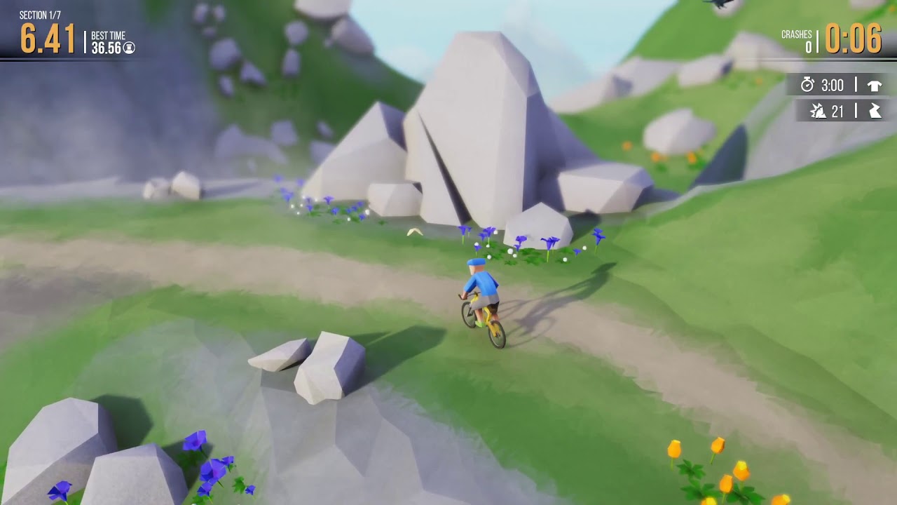

Here are examples of when I'm playing Lonely Mountains Downhill, I've supplied log files for both sessions:
The first video gets choppy at 15 seconds in, 32 seconds in, 50 seconds in, 1:07. 1:25.
The second video gets choppy at 14 seconds in, 32 seconds in, 49 seconds in
