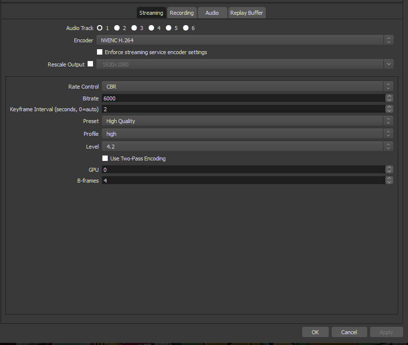

Now where I am at right now is, NVENC high quality, CBR, 6k bitrate, 1080p60fps, and some how it looks better then the 720p60fps on fast.

Well 6mbit just can only look as good and 1080p60fps would need at last 10mbit. Just use 720p or 900p. When I look at my own footage with 6mbit on 720p60fps in NVENC High Performance ( when my son Streams) its completely acceptable. You could bump up b-frames to 4 maybe this can help more

You can do that on your system. High Quality NVENC with 4 B-Frames and it will look perfectly fine. Just looked at 720p60fps High Performance NVENC 2 B-Frames footage of Overwatch that my sone streamed today. Is it somehow blocky? Yes a little bit but I can see everything good in high motion.

Could be my eyes man for real. Been streaming every night for 7 hours for a month now. You mention setting it to 4 B Frames?
n3v3rm1nd
Yes this will gives you better quality at the cost of latency (marginal, i mean the time for preparing the frames and sending them to twitch not input or anything gaming related!) and cpu/gpu processing power (propably marginal too)

So i got the exact same PC Specs and i test NVENC and All cpu preset from fast to slow.
So if you use NVENC use High Quality and not Default as preset. Level 4.2 and High as Profile ofcourse. Deactivate Use-Two-Pass-Encoding, and you can try to bump up the B-Frames. (Didnt try that yet).
But with all these settings i managed to get a better picture Quality with the CPU Preset fast then with the NVENC encoder. Medium looked good but not perfect. Slow looked almost perfect but u will never be able to stream in slow when u dont use a Streaming PC. It used like 90% of my 8700k.
