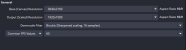

So, I have been streaming for the past few weeks and have been having problems with my stream.
I both record and upload and for the most part have had no problems. I have every now and then had to turn off "show preview" and then my stream would stop stuttering.
I have streamed games like Black Ops 6, Far Cry 6, Hell Divers 2, Fortnite, Minecraft, and Guild Wars 2. Both the recording and the streaming would work flawlessly. And every now and then I would turn off the preview to make it stutter less and it works.
Until last night... I loaded up Risk of Rain 2 with no mods and look at my stream and it it just stuttering every where. I turned down the graphics and it would stutter less for about 30 sec but then stutter all over again.
I listed my specs below, as I have had no problems so far.
I have read that maybe running the configuration wizard may help, but I don't think it has an option for both recording and streaming.
I looked at the log and see that my encoder is overloading but have no idea what that means.
Lastly, I spent a lot trying to get my recording settings to make my stream look clean when I upload to youtube and don't really want to downgrade, so I was also wondering if there is another encoder that could work on my CPU because at the moment it really isn't doing much.
I really want to keep streaming on Twitch and keep uploading my VODs to YT. I don't export from Twitch cause they downgrade my VODs and they don't look clean.
Any help would be greatly appreciated. <3
