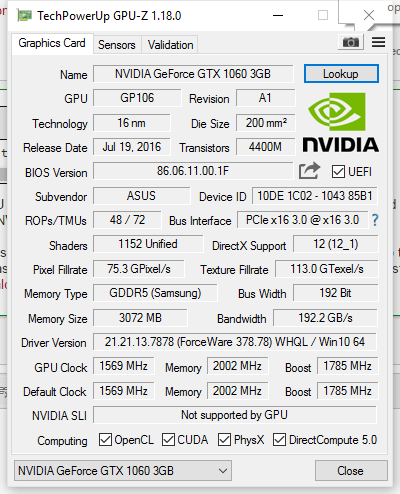

It's possible that your GPU is not installed in the correct slot as well. Did you put it in the slot closest to the CPU? Download GPU-Z and post a screenshot (the camera button in the program and upload to free image hosting) https://www.techpowerup.com/downloads/SysInfo/GPU-Z/

GPU-Z Link:
[QUOTE="This generally means that your CPU cannot keep up. Since it's a fairly weak AMD APU, you might need to turn settings down for streaming with x264 over NVENC.[/QUOTE]
Before i upgraded to ASUS Nvidia Dual GeForce® GTX 1060 3GB its working fine with 720p 30fps. GPU was added to the closest slot.
GPU-Z Link: http://gpuz.techpowerup.com/17/03/22/9mx.png
