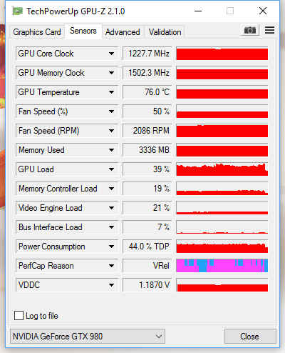

Please download GPU-Z and post a screenshot (the camera button in the program)
Download: https://www.techpowerup.com/downloads/SysInfo/GPU-Z/
Also, monitor GPU load as well as CPU. Since you're using the NVENC encoder, if your GPU is being overloaded somehow, it can cause issues with the hardware encoder on your GPU.

Ok, I downloaded GPU-Z and ran OBS Studio with Mass Effect Andromeda on my old setup for about 5 minutes.
Here's the results;
GPU-Z: http://gpuz.techpowerup.com/17/05/26/np6.png
New Log: https://gist.github.com/anonymous/93266ffee5f4fb336d760c37c706b32b
