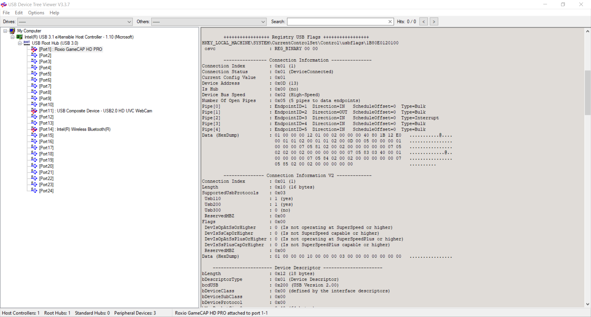

I downloaded a usbViewer, and noticed something that might be wrong with my usb ports. Here is what is shown in usbViewer:
https://i.gyazo.com/aeaae8371bcb53b325e532438da41940.png
I noticed that under "SupportedUsbProtocols," is shows that only usb110 and usb200 are supported. Does this mean that USB 3.0 is not working properly? My usb port should be capable of it, as there is an "SS" printed next to the usb port.
Narcogen
Yes, that is what that sounds like, and it would definitely cause your issue. Reliable HD capture pretty much requires USB 3.

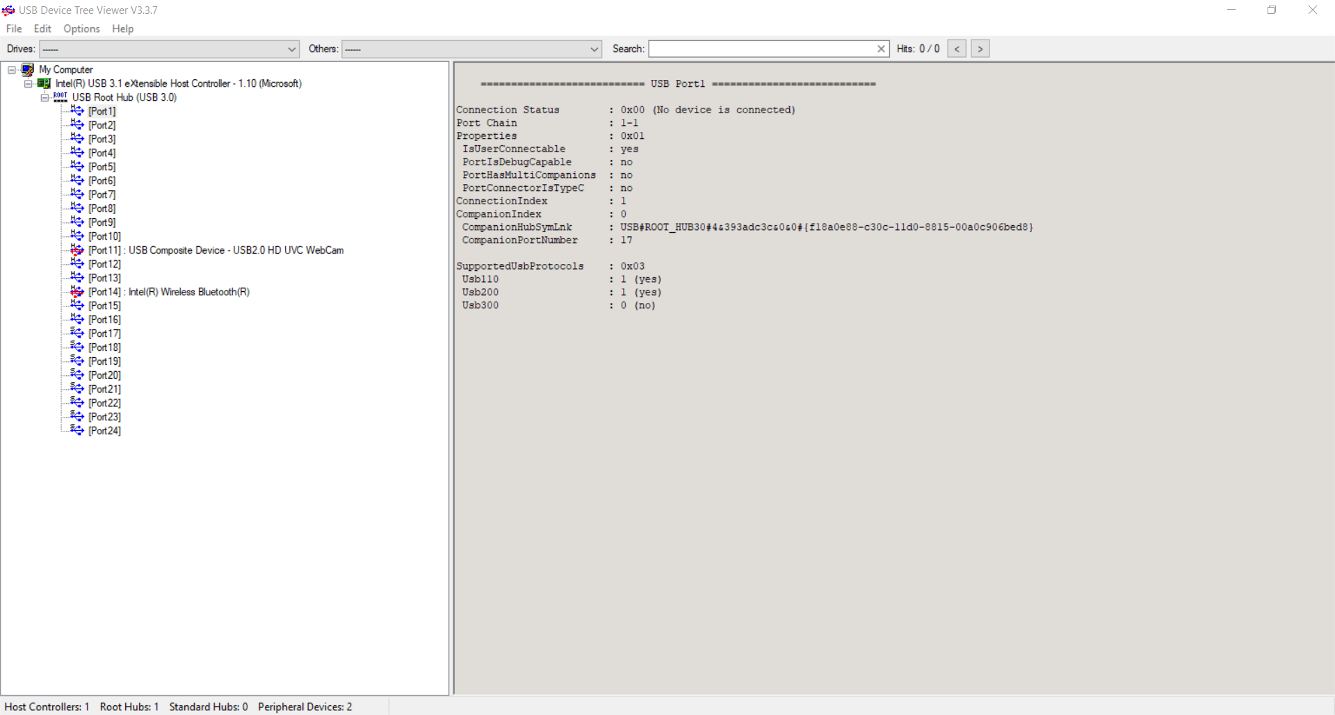

carlmmii
The "no" that you're looking at there is 100% normal. Not sure of the reasoning why, but checking my own view of the usbtree shows the exact same behavior.
That wouldn't even matter anyway -- the capture card you're using is a USB2.0 capture card, meaning it wouldn't benefit in any way from being connected to a fully functioning USB3.0 port (yours is probably actually fine).
Keep in mind, this is a capture device from 2012, with some very old quirks. I would see of you have the same behavior using the Roxio software that it comes with, if you still have that available. I remember when I used this exact same capture device that it was very finicky using anything other than their own capture "suite".
If it does have the same issues, then that most likely is an indication of something going wrong with the USB bandwidth, or the capture device just isn't able to perform its h264 encoding (possible overheating of the unit, which could be caused by heatsink failure over time).
