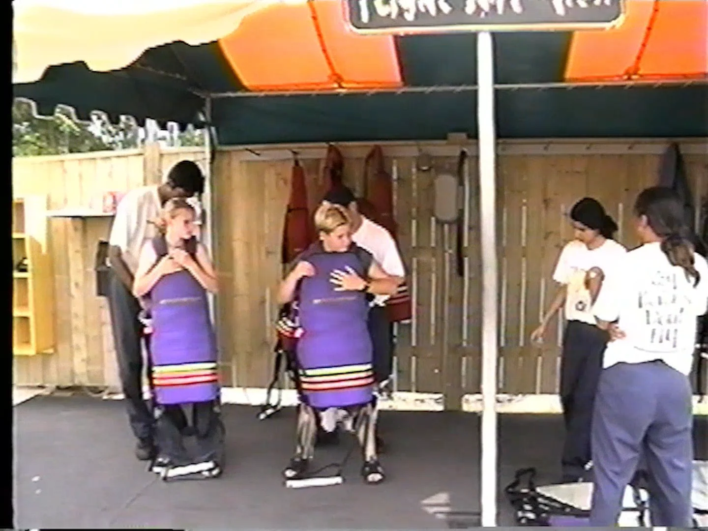

I am capturing tons of VHS to digitize everything in my collection and I am experiencing popping and cracking on everything. Below is a sample of what I am experiencing. Jump to 2:33 to hear the sound:
Let me clarify that this sound is not on the original VHS during playback via TV.
