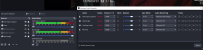

I have a computer set up to record video from component input to a Blackmagic 4k Intensity Pro, audio from a Zoom U-44 getting toslink input, and a second audio channel from the Blackmagic's analog input. The U-44 is through ASIO Input Capture.
I have my U-44 ASIO input set as the monitoring channels and it usually works fine. But sometimes it just doesn't work. The sound is recorded fine, but there's nothing coming through for monitoring. Sometimes restarting OBS several times helps, but now it seems to be permanent.
I have checked the output device so that's not the issue. Other sounds in Windows 11 work. There is a workaround which is setting the second audio channel to output through DirectSound, but I'd rather have it in the recording.
Any ideas for how to fix this, or is this just a bug? I can't find any other threads where this issue is described.
